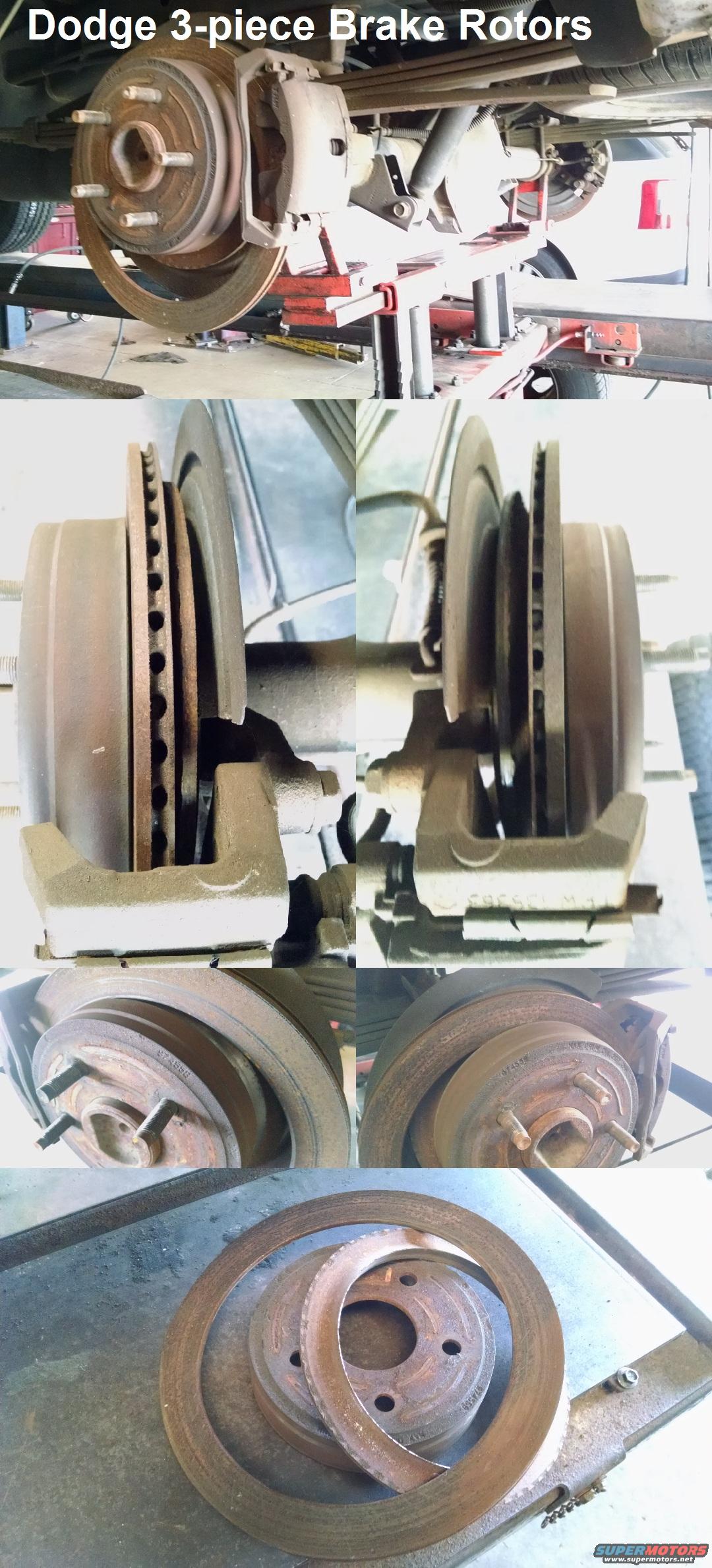

3pcrotors.jpg | Hits: 1483 | Posted on: 9/5/16 | View Low-Res
These were found on a truck that was driven to a local repair shop for "poor brake performance". The owner had let the rear pads wear away, and the inboard backing plates had eaten away the rotors until they broke off the hats - a seriously poor design by Dodge. Then he kept driving until the rotors cut into the hats again almost until another section came off. One of them DID come off when the mess was removed from the axle.
