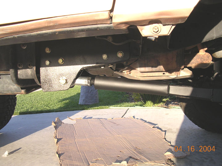

1" heims with 3/4 " bolts and spacers. the brackets were made to cover/use all holes made for all the rad arm brackets used to date. this was intended to increase frame strength
