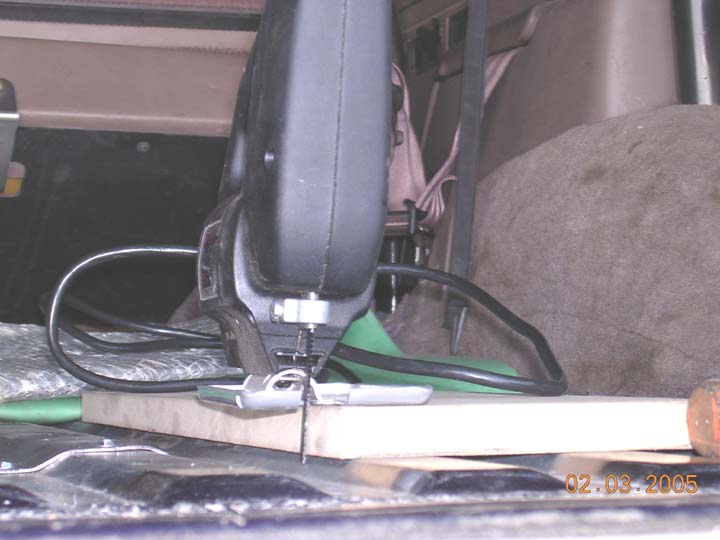

fuel pump acces panel
File 2 of 3
jigsaw.jpg | Hits: 974 | Posted on: 2/3/05 |
And a jigsaw with a piece of 5/8 and 3/4 ply to keep the blade from hitting the tank. Special care needs to be taken as there are hoses that you could cut if not careful
