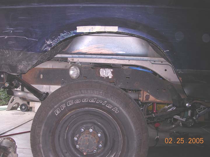

stretchdistance.jpg | Hits: 994 | Posted on: 2/25/05 | View Low-Res
I had tried for a 3.5" stretch to go with the klune and 205, but when installed and on the ground, the springs ended up giving me 4". the right most line is stock, the middle line is what I was shooting for, and the rear line is what I got. those marks are the center of the hub.
