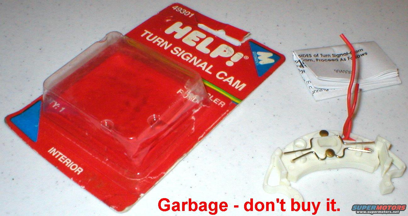

HELP! Turn Signal Cam (JUNK)
NAPA part# DL6126 is superior, but still a PITA
The bosses on the other side aren't molded right, so it doesn't return to center, and you have to bend & cut the silver "whiskers" to get it operate the lights right. Just bite the bullet and get a new turn signal assembly from Ford for ~$120 or RockAuto for ~$60.
Before buying cheap aftermarket parts, check for coupons & service offers from Ford.
