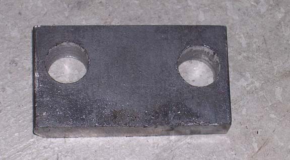

spacer.jpg | Hits: 1442 | Posted on: 11/20/03 | View Low-Res
there is two ways to do a 60 with radius arms. 1. grind the wedges to fit or 2. use a spacer. i used a spacer i made from 3/4" stock to allow me to use a ttb lower coil retainer which I had been wanting to make anyways for my fab tech coils
