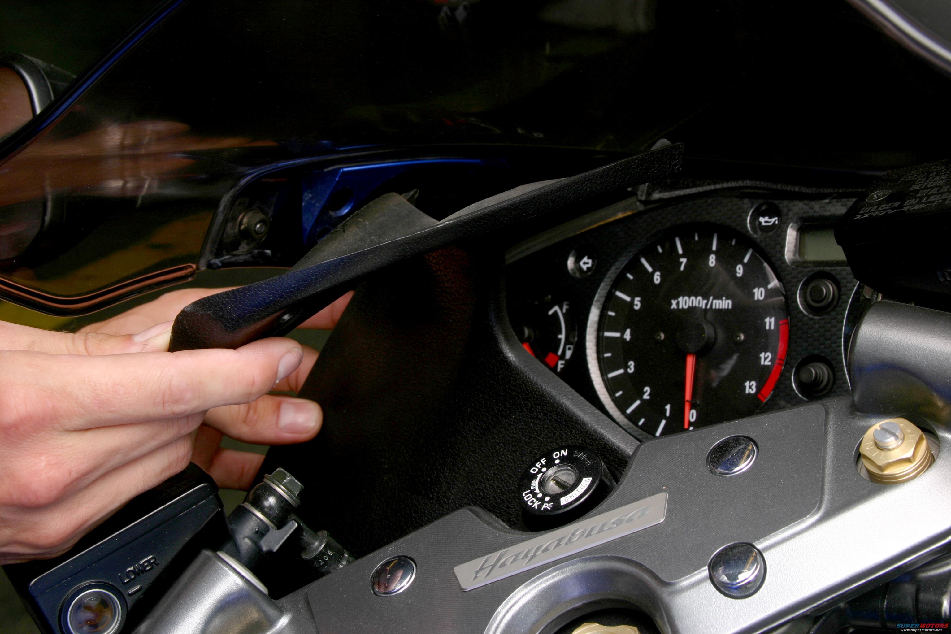

From the top, carefully pull the inner fairing away from the bike. The lower edge fits into the frame cover so you will have to slide it forward to release it.
