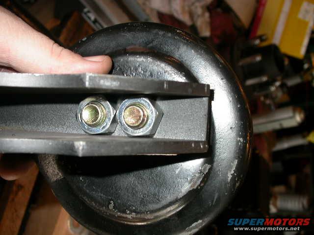

dscn5970.jpg Note that with the 9/16" nuts the sides of the radius arm mounts will hold them captive, so there is no need to hold the nut with a wrench when tightening the bolts.
