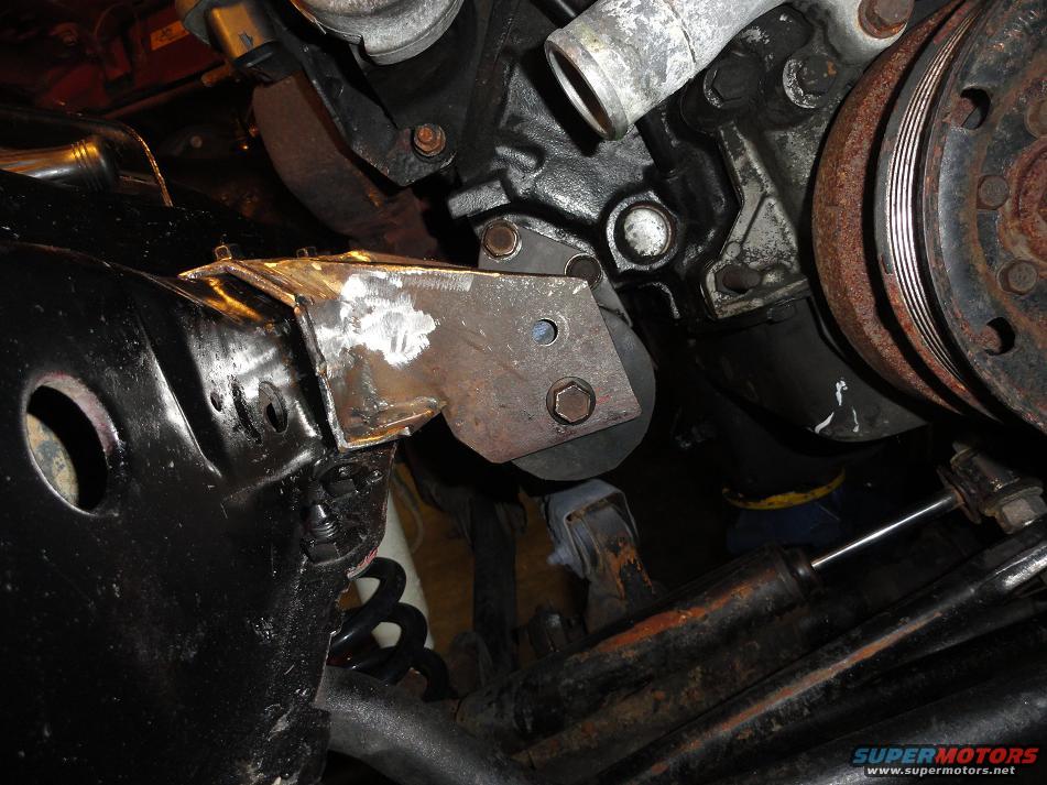

pass-mount.jpg | Hits: 480 | Posted on: 8/12/12 | View Low-Res
The final can be drilled in between the 2 shown for best clearances all around. if lower bolt hole is used stock zj exhaust manifold can contact frame rail.
hole should be inline with bottom lip of frame rail on both sides.
