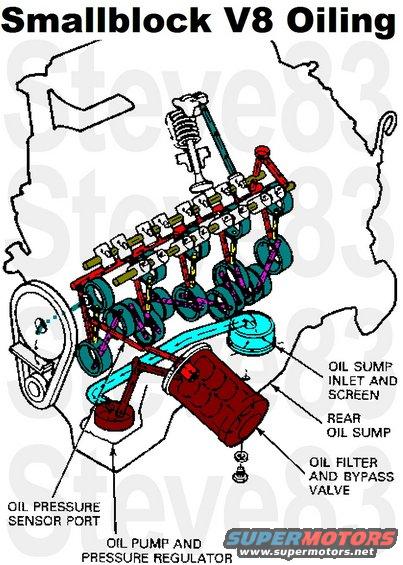

Smallblock V8 Oiling
IF THE IMAGE IS TOO SMALL, click it.
Oil pressure should be 40-60psi @2000RPM
Oil is lifted from the pan (sky blue) through the pickup screen & tube into the pump (dark red) which pushes the oil through the filter. The clean high-pressure oil (red) flows past the pressure port at the LHF of the block to the main galley along the RHS, which feeds the main & camshaft bearings (teal green) & rod bearings via the crankshaft (pink), and the crossover at the back of the block. The crossover supplies each lifter galley. As each lifter (HLA) reaches the bottom of its cam lobe, its bleed hole is exposed to the main galley's high-pressure oil, which fills it (with the help of the internal spring) to adjust out all the lash from that rocker. As the lobe raises the HLA, its bleed hole is blocked, maintaining that adjustment for that stroke. Leakage from each lifter flows up the pushrod to spill onto each rocker & valve guide. Spillage from the camshaft flows over the timing chain at low pressure. NOT SHOWN: some of the pressurized oil from the front cam bearing lubes the distributor bearings. Splash from the cam lobes lubes the distributor gear.
