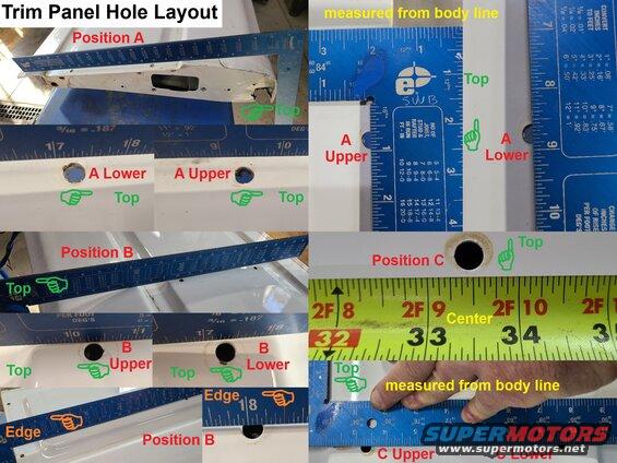

trimholelayout.jpg '87-96 Trim Panel Hole Layout
IF THE IMAGE IS TOO SMALL, click it.
Double-check against your trim panel's fastener locations before drilling. Carpet pin locations should be marked through the carpet's holes, after the carpet is aligned to the handle & centered on the t/g. Swingaway strike holes should be aligned to the interior structure and brace.
