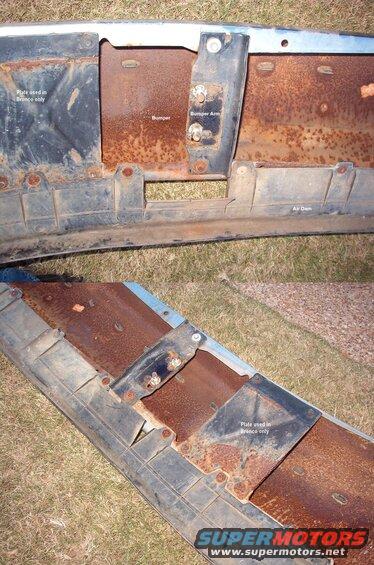

airdamslots.jpg By cutting 2 slits in the air dam, a flap can be folded down to allow a towing eye or light to protrude.  And the flap can be folded back up into place if it's not needed later. This is the only modification required to the truck.
