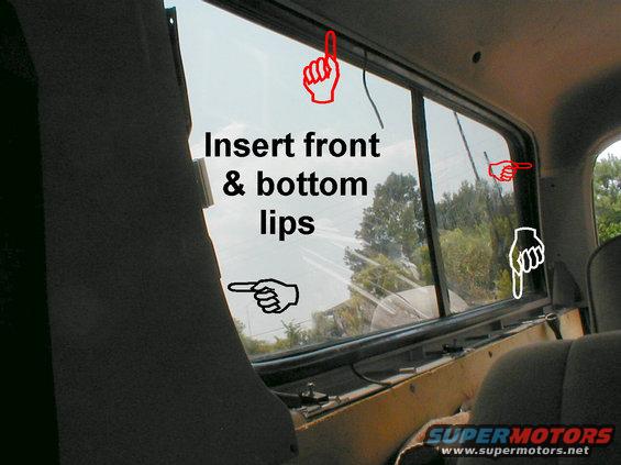

Camper Shell & Sliding Side Windows

Reverse of removal: start by setting the window assembly into the camper with as much of the gasket on the front & bottom lips as possible.
