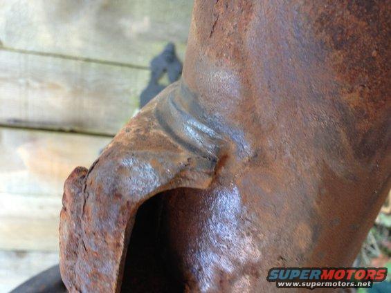

IMG_1174.JPG | Hits: 136 | Size: 74.26 KB | Posted on: 9/8/13 | Link to this image
The spring perches are crusty and very rusted. They might have to be removed to be rewelded and repaired.
IMG_1175.JPG | Hits: 154 | Size: 75.28 KB | Posted on: 9/8/13 | Link to this image
IMG_1179.JPG | Hits: 141 | Size: 66.86 KB | Posted on: 9/8/13 | Link to this image
I wire wheeled the welds on the spring perches to see if they were bad. They look godd, but they still might need to be repaired or removed.
IMG_1180.JPG | Hits: 146 | Size: 54.98 KB | Posted on: 9/8/13 | Link to this image
IMG_1181.JPG | Hits: 147 | Size: 81.02 KB | Posted on: 9/8/13 | Link to this image
IMG_1182.JPG | Hits: 151 | Size: 93.83 KB | Posted on: 9/8/13 | Link to this image
IMG_1183.JPG | Hits: 151 | Size: 66.21 KB | Posted on: 9/8/13 | Link to this image

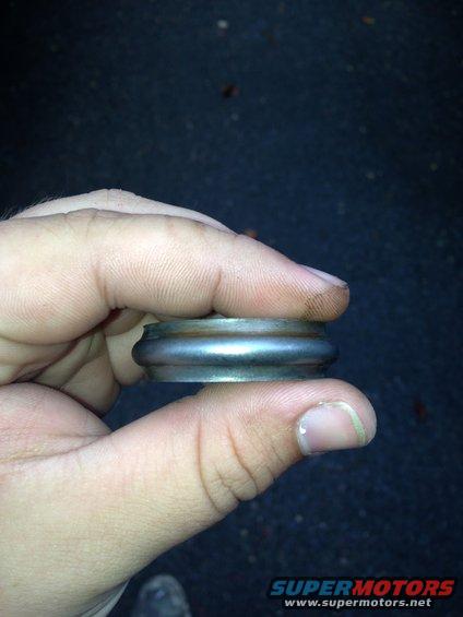

IMG_1195.JPG | Hits: 145 | Size: 51.69 KB | Posted on: 9/15/13 | Link to this image
I was questioning why the axle felt like it had no pre-load. I was even more shocked when I was able to back the pinion nut out with a 12" ratchet and one my hand holding the flange. I am pretty sure thius is NOT what a "used" crush sleeve looks like.
IMG_1196.JPG | Hits: 127 | Size: 49.25 KB | Posted on: 9/15/13 | Link to this image
