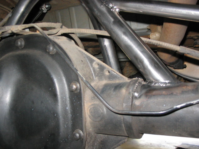

General idea with this truss is support right at the tube press fit to diff, with strong tie in support to diff at the pinion. So, the center section is what gets max. rigidity.
