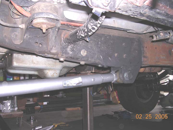

driversside.jpg | Hits: 1732 | Posted on: 2/25/05 | View Low-Res
drivers side. The cage arms mounted about 2" further back from where my other arms were, so I cut off all the old mounts below the frame. the new mounts eliminated the hope of reusing the stock tranny crossmember
