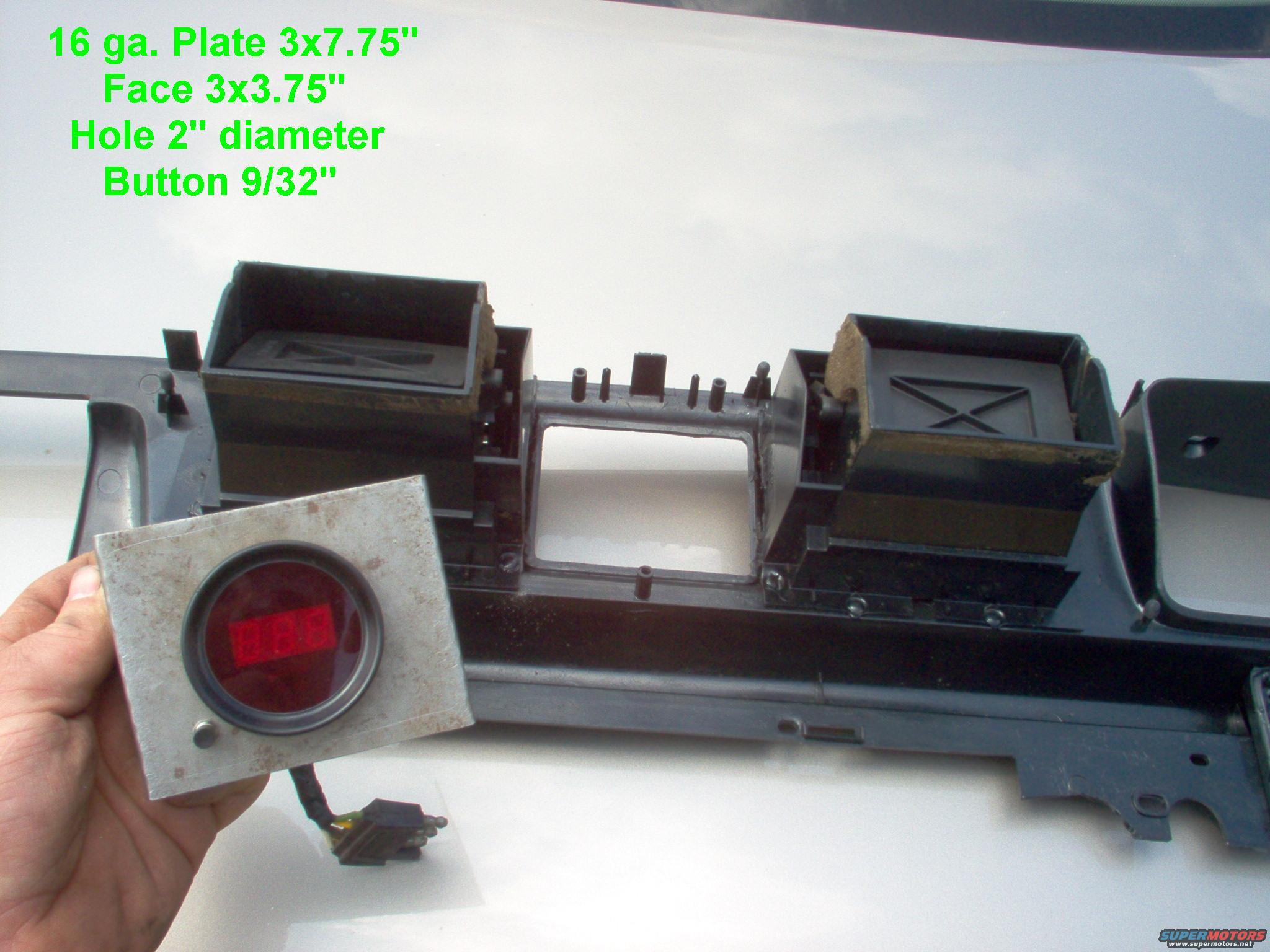

tachplate.jpg | Hits: 2147 | Posted on: 5/21/05 | View Low-Res
I used a scrap of 16ga. steel plate to make a mounting panel. A palm sander smoothed it out in no time. I have the switch threaded directly to the plate because I didn't want to see the shiny nut.
