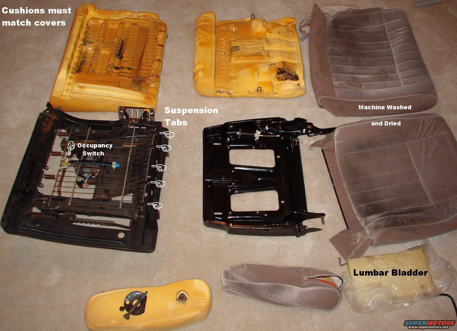

I had planned to use the '93 cushions, but their wire reinforcements don't match my upholstery, so I reused my pads. I added some wire to reinforce the front retainers for the seat springs - they were broken on this seat, and my original.
