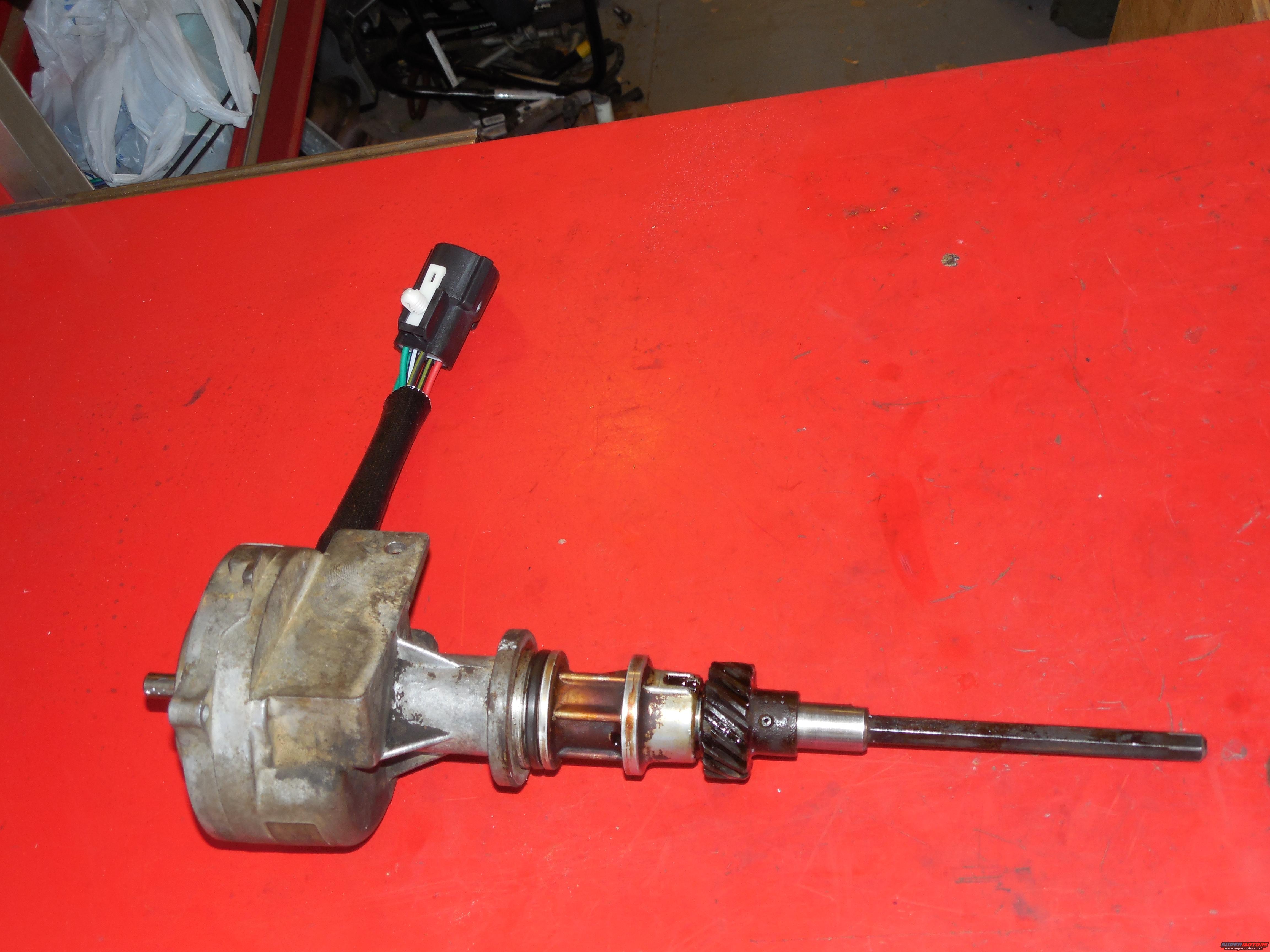

The PIP itself is simple to install - only getting to it is hard. Being careful of alignment, I hammered the gear back on, and drove the pin back in. It spins smoothly with no wobble. I primed it with oil before installation.
