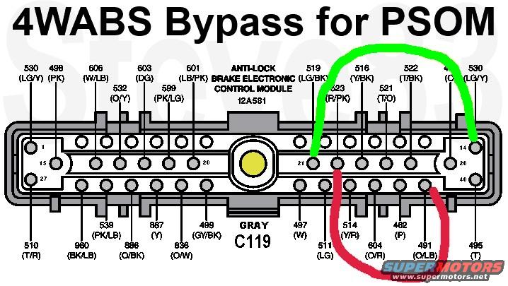

4WABS Bypass for PSOM
IF THE IMAGE IS TOO SMALL, click it.
When the 4WABS module fails (and they all will eventually), it's virtually impossible to find a replacement or reman (in 2026). So until they become available, this workaround will allow the speedometer, cruise, & transmission to continue working by delivering the ABS sensor signal directly to the PSOM, like in '92 Broncos and '92-96/7 Fs.
