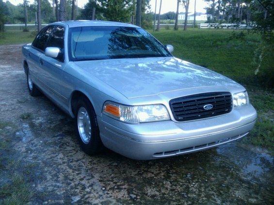

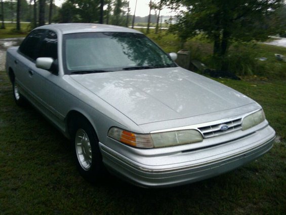

i finished the swap about 4 more hours of work today. i used the 96 turnsignal/marker light in the new headlamps then spliced off the ground and brown wire for the new side marker lights. the headlamps i used one factory ground and spliced into the power wire of each low and high beam. the grille is 5 or six nuts on top and pops in on the bottom. it came gloss plastic but i sprayed it flat black. i also had a roll of chrome mldg so i installed that around the bumper. the lower portion is supposed to have a splash shield the 1996 bumper had it integrated into the cover. i ran two screws under the cover into the rebar for now so the cover doesnt move while driving. i had to move the hood back some more because it was hitting the new header panel.
BEFORE
AFTER
