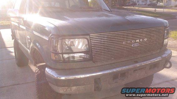

kimg0098.jpg i didn't end up taking any pics of the rest of the assembly but it was very easy and assembled like it should.
the projector i glued with JB weld to the metal piece on the headlight assembly i mentioned earlier to help support when offroading. the shroud i also glued in place.
for the lenses i cleaned the old glue out best i could and used ARBO Windscreen Tape  which was avalible at DDM Tuning but i could probably of reused the original glue if i needed to.
i went ahead and installed the headlights along with new marker lights, turn signals and headlight doors.
this is how it came out. the black looked much better than the chrome the truck originally had. the grille needs to be painted black and the truck was still muddy from offroading the previous weekend.
