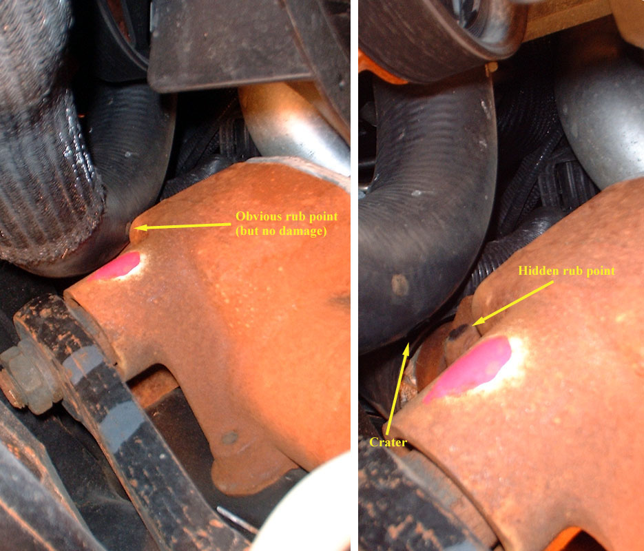

The lower radiator hose is "T" in design or a hose with three connections.
Lower Hose Ford MSRP price $58
From what I know it should take under 2 hours along with replacing the coolant.
It's the upper clamp that's a bear to get to
On the early 6.0L's the hose would rub against the steering box causing it to leak,the updated hose (2004-up)now clears the interfering steering box.
