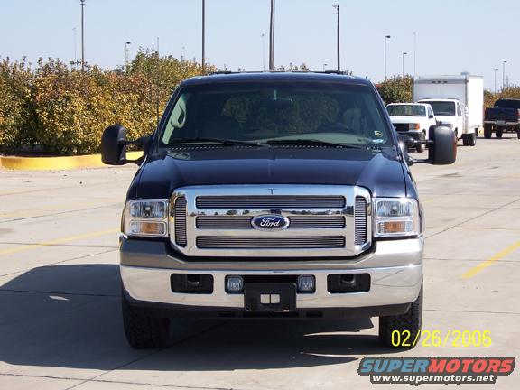

here is a neat little mod for the older Excursions.
Anyone see anything different?
Before
After
