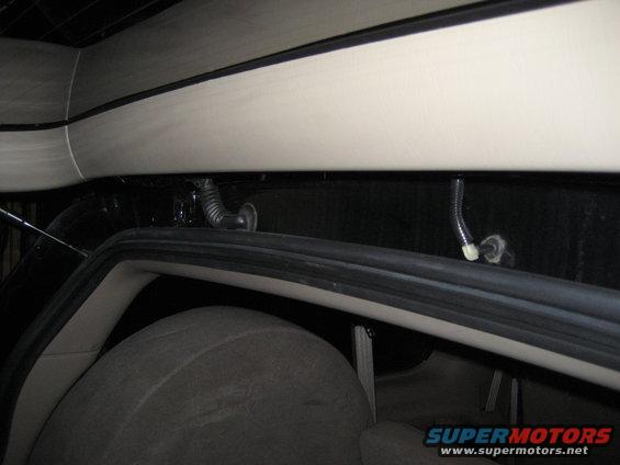

Nope they short changed us on the 05's
no vent, just the plug...
dunno how to upload a pic

http://www.supermotors.net/getfile/526951/fullsize/ex-liftgate-1.jpg
http://www.supermotors.net/getfile/526951/fullsize/ex-liftgate-2.jpg
http://www.supermotors.net/getfile/526951/fullsize/ex-liftgate-3.jpg
2005 X Limited 6.0L stock

The vent had to have gotten relocated elsewhere on the body as you need flow thru on these trucks just like the SuperDuty trucks.

Could always drill a small hole run the wire lead thru pop a rubber grommet in around the wire and seal it in the same placement as the weather plug on our 02.
We had the antenna on the front center of the dash next to the lights on sentinel and it just didn't receive all that well for us,moved it outside then it all cleared up,even the terrestrial repeaters came in alot better when in the concrete jungles.

Thanks to everyone, I finally got a chance to install the new antenna today. I routed it through the rubber plug and underneath the headliner, then down the pillar post.
