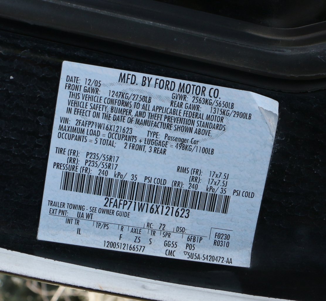

Check and make sure that you have the correct wheels/rims on your car as FORD had a problem with the axle bearings on certain models.
The problem occurred when they switched to the offset rims on the 17" wheels from the non-offset 16" wheels. The problem caused the axles to not be properly centered in the bearings/races and caused the exact symptoms you are describing.
You should be able to find the wheel size on the label in the drivers door jamb area, and then double check that against the size on the tires. Hope this helps.

Hi
just checked says 17X7.5J Car has 80K miles on it
