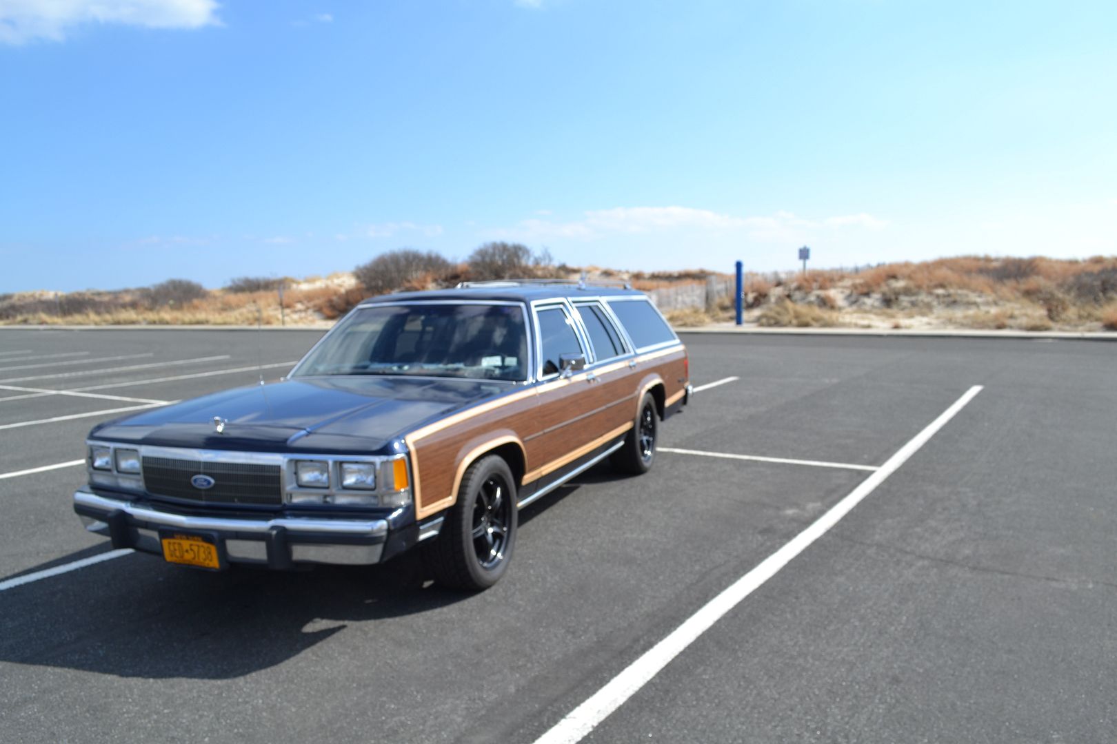

hondaclf> I noticed your comment about SN95 wheels, and I am trying to mount the 07 spinners to my 87 Wagon as we speak. I came across the wheel spacer conundrum last night trying to mount the fronts. Are you using hubcentric spacers on your front? Still have info on them?
Thanks
