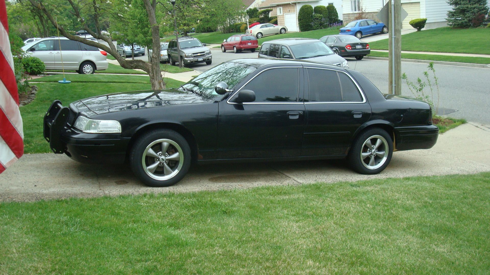

Nov 20, 2012 at 4:37 PM
No spacers needed!
Any wheel(aside from the polished Bullits) off an '05 or newer Mustang will bolt right onto any '03 or newer Grand Marquis, Town Car or Crown Victoria.
what tires do those wheels come with?
I have an '05 and had '05 Mustang Bullits
and now have 2010 GT500 wheels
