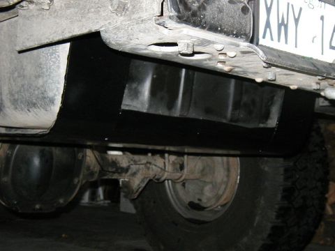

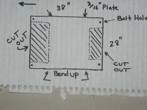

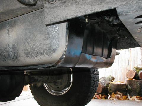

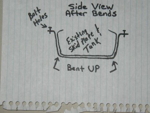

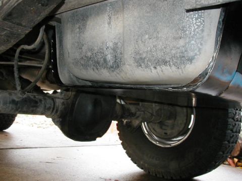

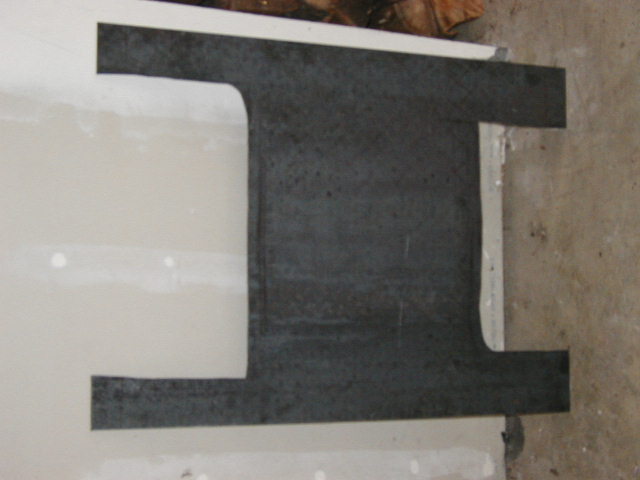

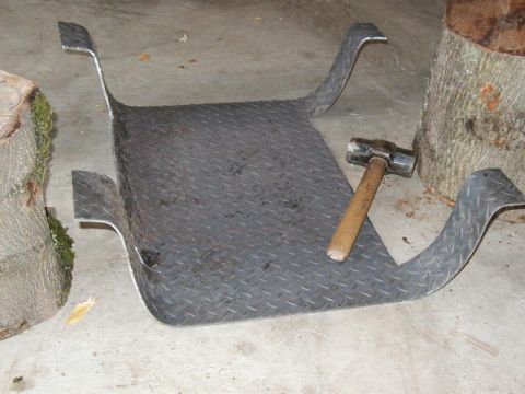

1995 Ford Bronco - Started with a rectangular sheet of 3/16" diamond plate that weighed apx. 50 lbs! Cut it down to this big "H" 1995 Ford Bronco - steel bending using the ol BFH. 1995 Ford Bronco - Mounted up over the stock skid, which is still on. The rear lip is a bit unever, so the last pic shows a recent take off where I worked on… 1995 Ford Bronco - Attached up top at the stock bolt locations 1995 Ford Bronco - The diamond plate is on the inner side, so it's smooth on the outside. Diamondplate also makes the strength of this plate stronger and heav… 1995 Ford Bronco - Underside view of a vehicle's fuel tank and rear axle, showing mechanical components. 1995 Ford Bronco - Diagram of the H cut needed 1995 Ford Bronco - Diagram from the side of the bending needed to attach it.

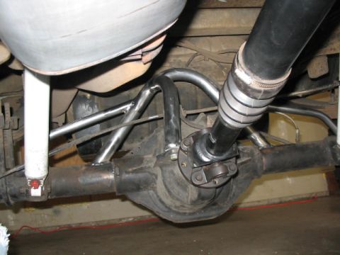

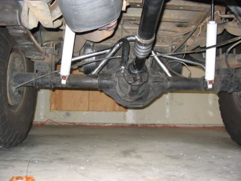

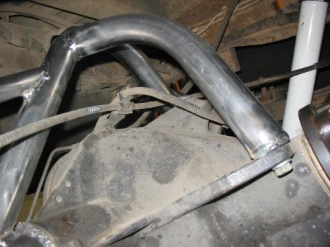

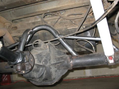

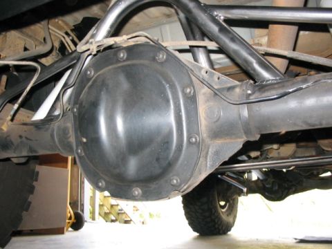

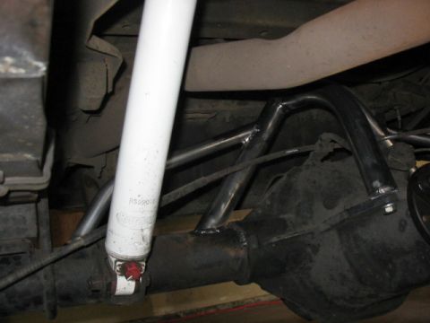

1995 Ford Bronco - Engine bay detail shot showing various hoses, wiring, and metal components. 1995 Ford Bronco - A look at the whole truss 1995 Ford Bronco - Clearance is 7-8" up to body from the highest point, should even allow jumping if I ever desired to do so. Trail articulation this will not… 1995 Ford Bronco - I like 8.8's, but they seem prone to tube to diff loosensing and then bending or spinning at this joining. The 8.8 tubes are 3.25" Dia. but… 1995 Ford Bronco - Should be ok with exhaust, a little trail testing will tell. 1995 Ford Bronco - Some may wonder why the truss loop over the diff is so high up...this allows the tube coming forward to tie into the large piece of reinfor… 1995 Ford Bronco - nudder shot of the 1.5" brace coming forward to tie in near pinion. 1995 Ford Bronco - The underside of a vehicle shows the rear differential, suspension, and a custom roll cage structure.

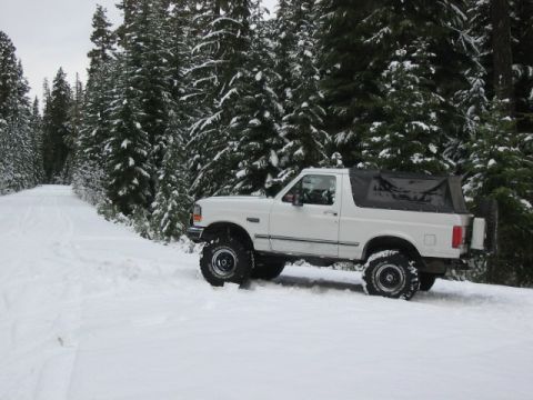

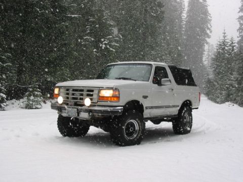

1995 Ford Bronco - Timothy lake, Oregon, nestled in off Rd. 42, by Gov't camp. 1995 Ford Bronco - 1995 Ford Bronco parked on a snowy forest road. 1995 Ford Bronco - A winter landscape with snow-covered pine trees and a tranquil lake under a cloudy sky. 1995 Ford Bronco - A dog stands on a snowy shore next to a calm lake, with a forest and mountains visible under an overcast sky. 1995 Ford Bronco - A white 1995 Ford Bronco with a soft top navigates a snowy forest road. 1995 Ford Bronco - White 1995 Ford Bronco navigates a snowy forest road during a snowfall. 1995 Ford Bronco - A 1995 Ford Bronco navigates a snow-covered road in a wooded area during a snowfall. 1995 Ford Bronco - Driving on a snowy road through a dense forest during a snowfall.

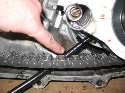

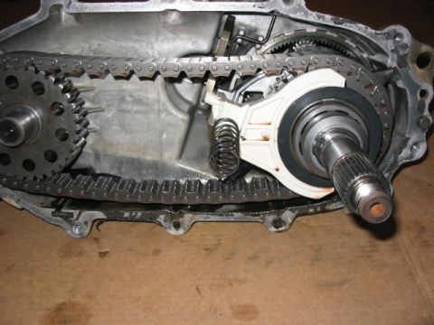

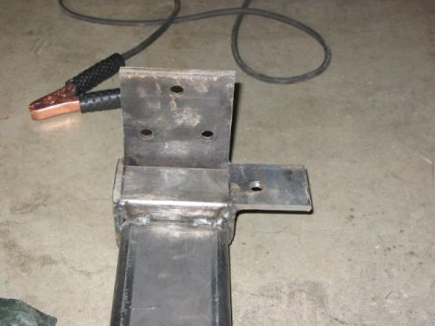

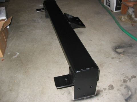

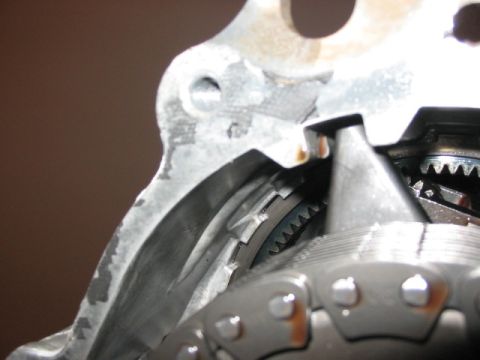

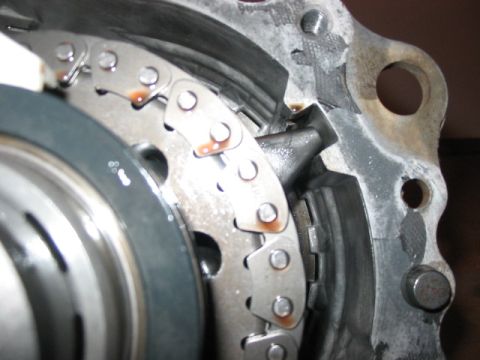

1995 Ford Bronco - Internal components of a transfer case, including gears and a drive chain. 1995 Ford Bronco - Internal view of a transfer case component, highlighting the chain and gear mechanism. 1995 Ford Bronco - Internal view of a vehicle's transfer case, showing chain and gear mechanisms. 1995 Ford Bronco - Close-up view of a vehicle's timing chain and associated engine parts. 1995 Ford Bronco - Interior view of a disassembled transfer case, showing internal components like chains and gears. 1995 Ford Bronco - Starting to fab a new E4OD crossmember...old one won't work since the cage radius arm attaches so far back on the frame, about where the st… 1995 Ford Bronco - A close-up view of a custom metal bracket, likely for vehicle modification, attached to a steel beam. 1995 Ford Bronco - Go to the end of the pics, this pic reloaded, not sure what happened.

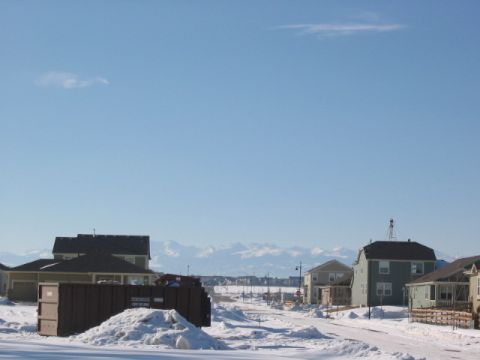

1995 Ford Bronco - This is a drawing of a two-story house with a three-car garage and a covered front porch. 1995 Ford Bronco - A large, bare tree dominates a winter landscape with a building and mountains visible in the distance. 1995 Ford Bronco - Another shot of the "premium" lot. Back of house will face toward the west (front range) so views from the master bedroom, kitchen, and fam… 1995 Ford Bronco - Spiral staircase viewed from the front entrance 1995 Ford Bronco - A view of a home's interior staircase, a curved dark wood banister and carpeted steps. 1995 Ford Bronco - Interior view of a home's kitchen and dining space, dark wood cabinetry and a central dining table. 1995 Ford Bronco - A wide shot of a snowy landscape with a large, bare tree dominating the center, under a bright sun. 1995 Ford Bronco - 8' kitchen island

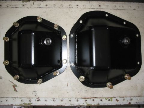

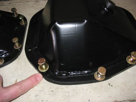

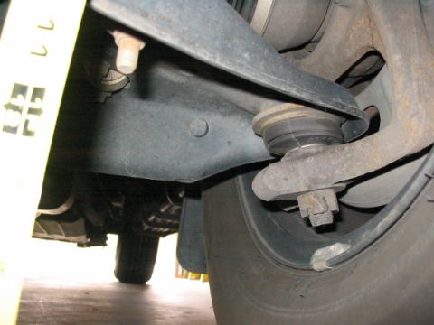

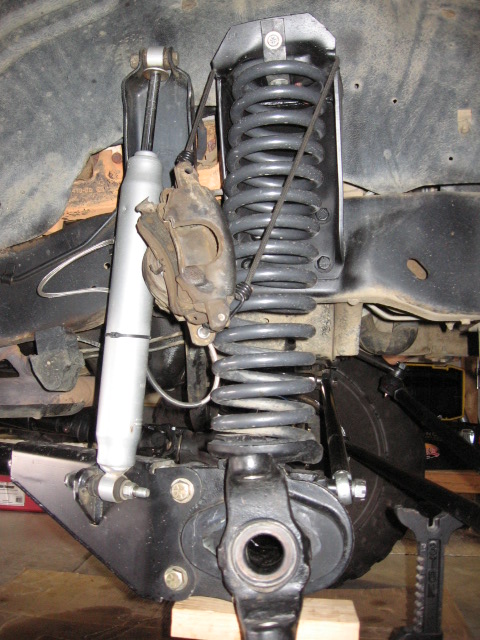

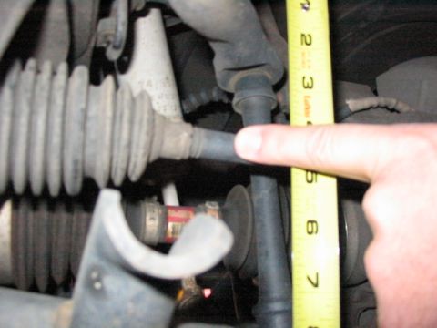

1995 Ford Bronco - '00 Merc Mountaineer steering 1995 Ford Bronco - Measuring suspension components with a tape measure. 1995 Ford Bronco - Balljoint setup 1995 Ford Bronco - Radius arm has a hex end that pushes into the A arm. 1995 Ford Bronco - This document is a flyer for a Bronco enthusiast club, graphics of modified trucks and event information. 1995 Ford Bronco - Ruffstuff Specialties new diff covers for the 44 and60 rear. 1995 Ford Bronco - 3/8th's A50 plate steel is used, very thick. Painted Satin Black with grade 8 zing/bling longer bolts. 1995 Ford Bronco - totally enemic pic of wanting to place lower axle trackbar mount into double sheer via welded on bracket.

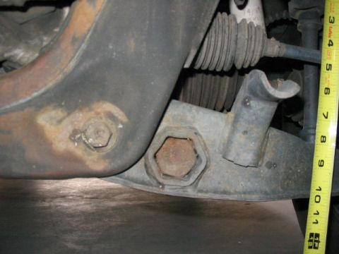

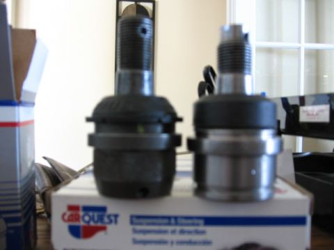

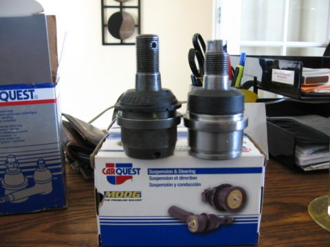

1995 Ford Bronco - Composite image shows a lifted pickup truck alongside a motocross rider and wheel graphic. 1995 Ford Bronco - A single black and chrome wheel with a multi-spoke design and visible branding is shown against a dark background. 1995 Ford Bronco - A single black and chrome ION ALLOY wheel is shown against a black background. 1995 Ford Bronco - stock bumpstop reused 1995 Ford Bronco - A tape measure is used to show the height of suspension components on a vehicle. 1995 Ford Bronco - time for new balljoints. Moog greasable k8194T upper on the left, Spicer 706116x non greasable on the right. What I found very cool with th… 1995 Ford Bronco - A comparison of two ball joints, one appearing older or dirtier than the other, resting on a CARQUEST suspension parts box. 1995 Ford Bronco - only took about an hour to remove everything.

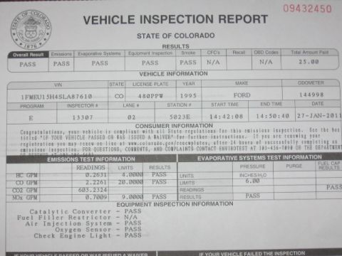

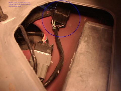

1995 Ford Bronco - All pics from other FSB members 1995 Ford Bronco - Undercarriage view shows various components, including a temperature sensor plug and wiring harness. 1995 Ford Bronco - Steve83 pic for reference 1995 Ford Bronco - Colorado emissions are now something I must deal with. And their equipment can't take a tire larger than 34" (DOH). 1995 Ford Bronco - Side view of a white SUV with a black soft top, parked indoors. 1995 Ford Bronco - This document is a vehicle inspection report from the state of Colorado, dated January 27, 2011. 1995 Ford Bronco - The planned fan, probably make it a puller since I don't have the AC condensor and have room behind the E4OD cooler (it won't be on all the… 1995 Ford Bronco - This would be plumbed into the rear line right at the master cylinder after I replace the residual valve with the gutted one. Just would li…

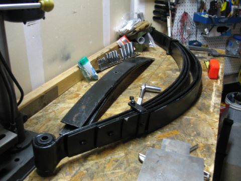

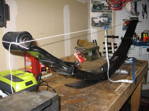

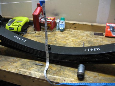

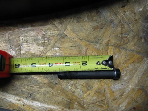

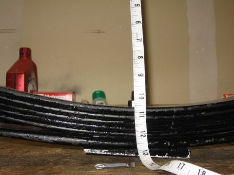

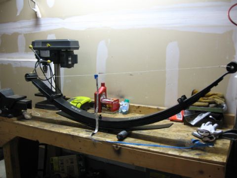

1995 Ford Bronco - The next 4 pics are just the new springs and a few details sitting unloaded. I intend to use a zero rate 1" lift so these appear to be… 1995 Ford Bronco - These days, I'm not after super soft articulating springs for the rear. What I want is nice ride, can still hold some decent load, articula… 1995 Ford Bronco - Leaf springs are shown with part numbers and a measuring tape, indicating a measurement or inventory process. 1995 Ford Bronco - Leaf spring assembly with part number 23411 visible, on a workbench with tools and a charger. 1995 Ford Bronco - A bolt is measured with a tape measure, indicating its length. 1995 Ford Bronco - Leaf springs and tools are laid out on a workbench, ready for installation. 1995 Ford Bronco - Our new dog Banksy we picked up this week. Not sure what the name means, but the little guy has a few issues and we didn't want to make it… 1995 Ford Bronco - Dog sleeping on a dog bed, wearing a camouflage bandana.

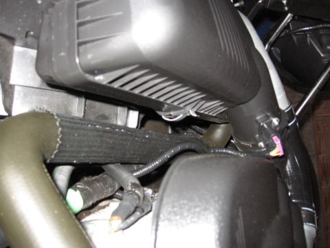

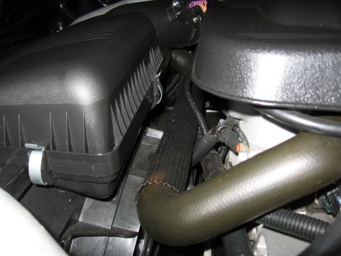

1995 Ford Bronco - Engine bay details including air intake and various hoses. 1995 Ford Bronco - Detail shot of various hoses and electrical connections within the engine compartment. 1995 Ford Bronco - We picked up Connie Coupe Aug. 12 with 4132 miles. It's an 09 Pontiac Solstice GXP Coupe, one of 1266 before Pontiac shut down. Last model… 1995 Ford Bronco - A black Pontiac Solstice GXP Coupe is parked in a lot, displaying its distinctive front grille and headlights. 1995 Ford Bronco - Black Pontiac Solstice coupe with a Colorado license plate. 1995 Ford Bronco - Black Pontiac Solstice GXP Coupe parked in a lot with mountains in the background. 1995 Ford Bronco - Rear view of a black Pontiac Solstice GXP Coupe with a custom Colorado license plate. 1995 Ford Bronco - This black Pontiac Solstice GXP Coupe is shown from the rear three-quarter angle in a parking lot.
