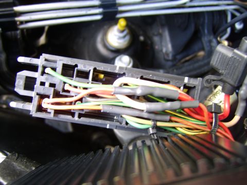

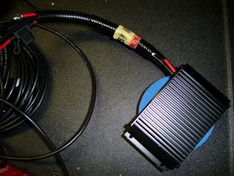

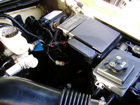

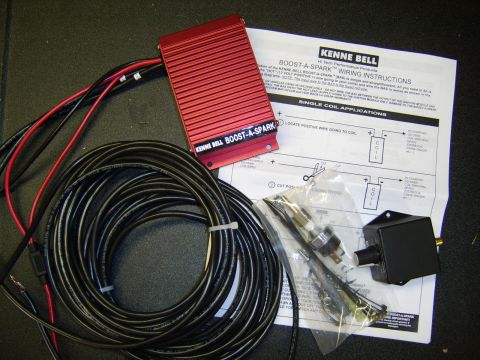

1996 Mercury Grand Marquis - Here is the Boost-a-Spark (BAS) kit out of the plastic bag. In the bag is a 4 psi pressure switch and some installation parts (vac tee, hos… 1996 Mercury Grand Marquis - Since I want a factory appearing engine bay, the attractive anodized red finish had to go. I painted the module a satin black color. I used… 1996 Mercury Grand Marquis - The wiring was spliced into the coil power feed near the eec diode, under the relay center. Normally the outside wire goes to the coils on… 1996 Mercury Grand Marquis - Don't really have a good picture yet, but here it is installed. I mounted it to the side of the vacuum reservoir using self-tapping screws…
