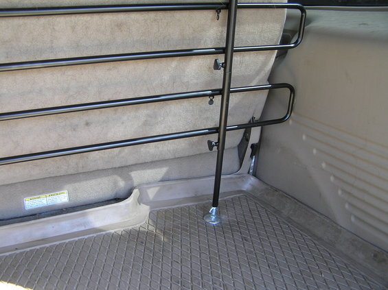

This is not a great picture, but at least shows you the location of this lever. It's the only pic I have of the back, but the little "hump" in the floor mat is for the lift lever to remove the seat:
