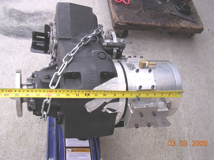

doublerlength.jpg | Hits: 1274 | Posted on: 3/4/05 | View Low-Res
klune/205 with 3/4 spacer beween klune and tranny, as well as klune/205 with the mounting foot (1/4") is 19.25". You could cut the tranny output shaft by 5/8 or 3/4" and make it 18.5 inches, but I didnt want to since I stretched the WB 4"
