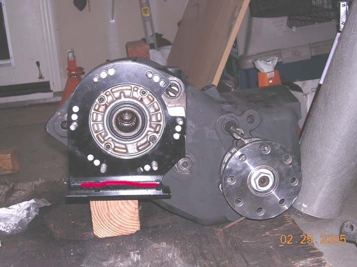

205ready.jpg | Hits: 1698 | Posted on: 3/4/05 | View Low-Res
I clocked the 205 up some, which required cutting the mounting foot where the red line is, and then bendingthe right side of the foot down approx .5inches to get the foot level with the clocking. The lack of clockable foot mounting is the biggest issue with mounting the klune
