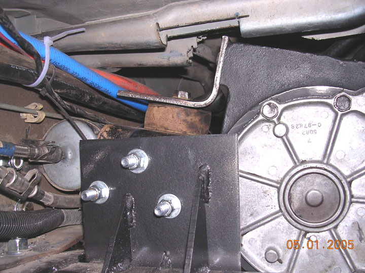

doubler crossmember
File 30 of 32
2torquearm2.jpg | Hits: 880 | Posted on: 5/2/05 |
I turned the stock lower mount 90 degrees and welded this 1/4 plate to the XM. then, using 3/8 bolts mounted it up.
