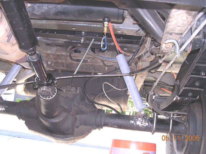

I cut some ears out of 1/4 flat to weld to the top. These are 12 inch travel ranchos, set for 3.5 of up travel at 63 degrees. I can move the uppermount towards the center and get an additional inch of uptravel, but initial test drive shows I have plenty of shock up and down. i also used door springs for home depot to hold up the E brake lines after the wheelbase stretch
