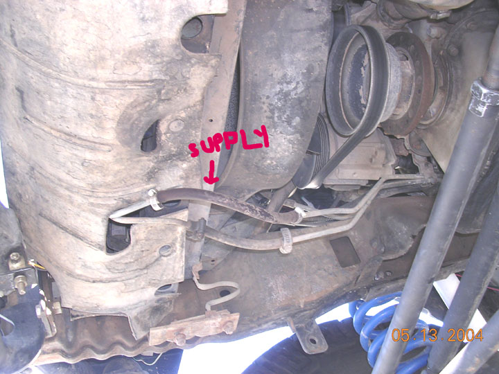

here is where I cut the stock lines. the line on the left is the stock soft section return line that comes out of the auxilliary cooler. On the right, the hard line bent and ran to the "radiator cooler". I cut that, ran a soft line and piece of hard line to the bottom input of the new cooler, and then ran a soft hose from the top port on the new cooler to the input side of the stock auxiliary cooler
