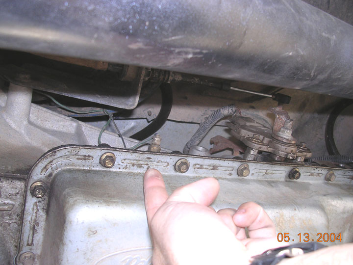

this is where I put the tranny temp sender for the pillar gauge. this is a pressure port on the E40D. It prolly reads about 5 to 10 degrees hot from the radiant heat, but gives me a good idea. The cooler fan is switched at 160 IIRC, and it is pretty close to the temp readings I get.
