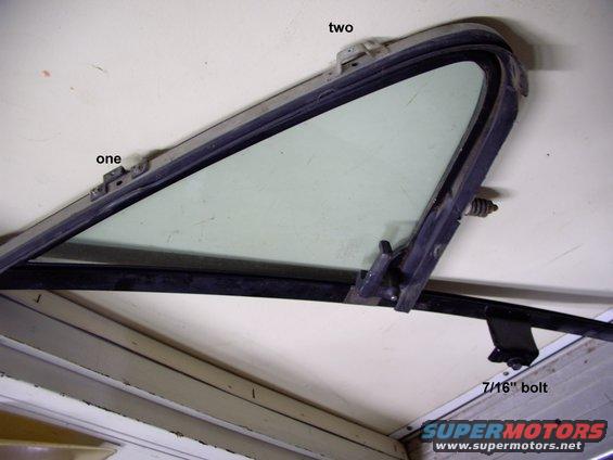

One and two note where the philips hold it on. The 7/16" bolt is under the inner door trim panel. just be careful removing the up and down window seal.
