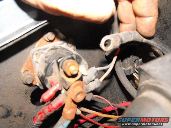

Here's the 2 gauge, stock starter cable being removed from the top post in preparation for mounting it onto the lower (always hot) post. The starter will not start because there is no signal being sent to it yet (that and you disconnected teh battery right?).
