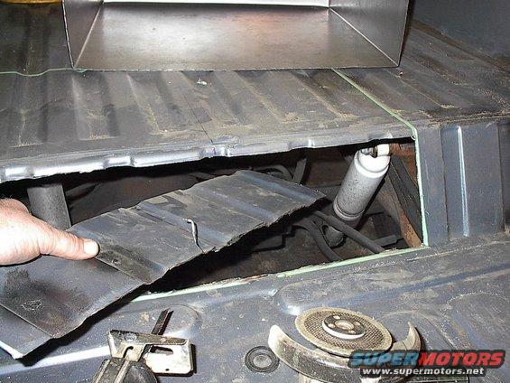

Once you remove the upright floor piece, keep it for patches later, a rust sets further in. I ran a sanding drum around the inside edges of the opening to clean up the burrs and sharp edges.
