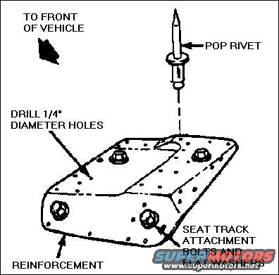

16. Using the holes in the left hand reinforcement as a guide, drill six (6) 1/4" (6.35 mm) diameter holes through the reinforcement and floor pan in the locations shown.
a. Install one (1) pop rivet in each of the critical locator holes immediately after drilling the individual hole.
