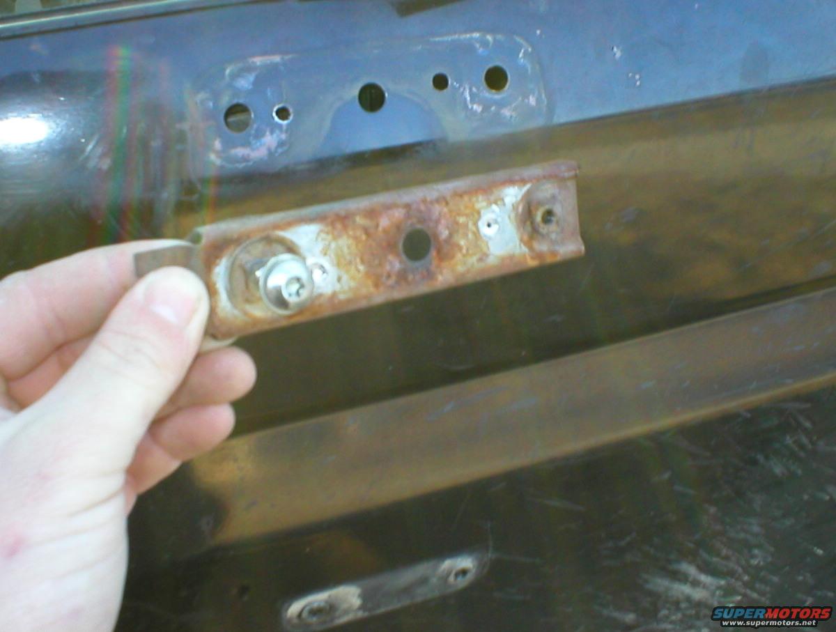

I drilled out the spot welds to remove the nut plate, but I reused it later.
Screws are T30 button head M6x1.00x20mm.
