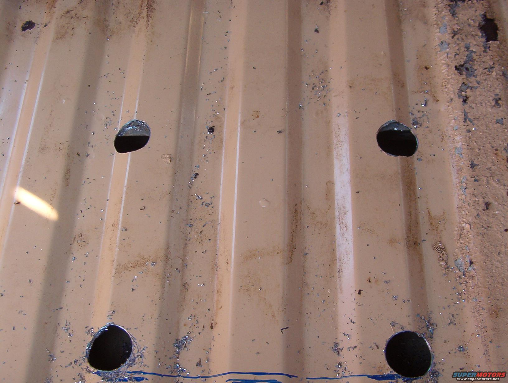

04holes.jpg | Hits: 4586 | Posted on: 6/25/09
| View Low-Res
NOT following my own advice, I didn't trace the cover plate onto the floor first. The front L hole is slightly too far forward, but it's still good enough for the cover plate I have. The farther back the rear edge is, the more likely you'll cut the tank.
A slitting chisel in an air hammer is a FAR-BETTER way to cut the hole, and doesn't require any prep.
