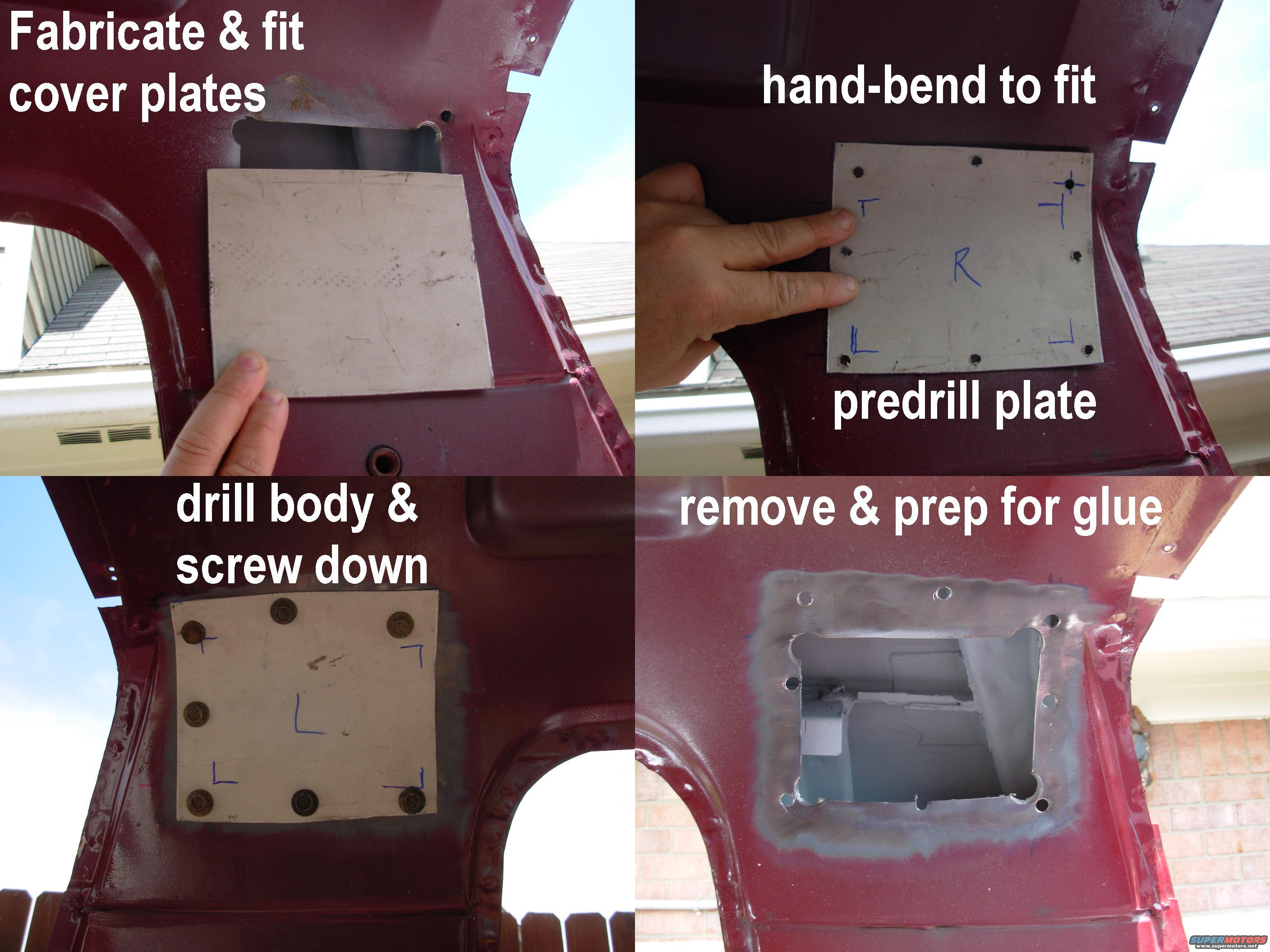

96-20-11 Bronco Roof Cracks
File 23 of 26
plates.jpg | Hits: 2501 | Posted on: 6/13/12 |
I found a piece of scrap about the right thickness, cut it into plates, fit them to the body's curves, marked & predrilled them, then drilled the body the way TSB 951409A recommends.
